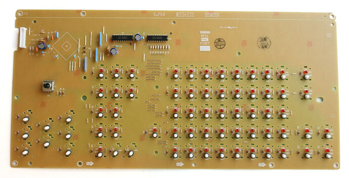

All Motif XF keyboards (XF6, XF7, and XF8) use the same mainboard:
All Motif XF keyboards also share the same right panel (PNC) board:
Neither the main boards nor the panel boards are interchangeable between the XF and XS keyboards.
